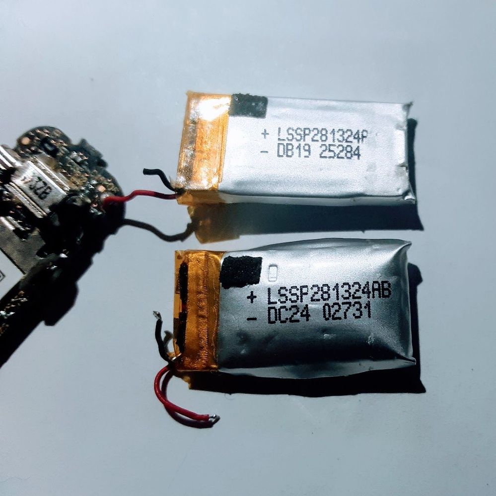

I'm installing a new battery right now, the original battery is the one I'm scared of exploding, it's expanded greatly, much larger than the tracker's chassis was designed to accommodate due to how LiPo batteries degrade over time. Inspecting everything carefully, cleaning where needed, and successfully installed the replacement 🙂
Here's a good original working perfectly Fitbit One battery, vs. one that's greatly expanded ...YIKES!
Top one = good, bottom one = YIKES!
LOL, the only problem with this particular one pictured was something that happened at the factory level, the battery wasn't properly soldered in, I found a perfectly brand new battery inside what was considered to be a dead tracker - WOOT!
TL:DR: eBay One Batteries
