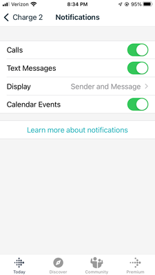

I have a charge 2 if that matters. I’m trying to set up notifications to my Fitbit from my Ring doorbell. When I go to the notifications area on the Fitbit app, there is no option for “app notifications”. I know this is possible bc my coworker has this function.
I updated the app. No difference.
Please help 🙂

@SunsetRunner I was so surprised when I saw your screenshot, that I found my old Charge 2 and added it back to my account. My notifications page is the same as yours. I re-read Fitbit's Help article on Notifications. It is very long, but there is a chart in there that lists the types of notifications each device can receive. The Charge 2 can't receive app notifications. So, yes it does make a difference that you have a Charge 2.
I apologize that it took me this long to get you the correct answer.

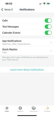

Hello @SunsetRunner and welcome to the Community. Just to clarify, the path to set up App Notifications is profile picture > Charge 2 image > Notifications:
iOS app view
If you don't see this, can you please post a screenshot? I don't think it is related to using a Charge 2. My husband has a Blaze and it was released around the same time as the Charge 2. He has the App notifications option.

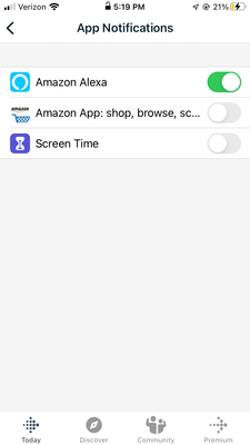

@LZeeW I went ahead a bought myself a (used) charge 3. I am still not having any luck with the app notifications 😞 Here is a screenshot of what I see when I go to the app notification screen. I have found nothing helpful anywhere about why the ring app is not showing up. I have reset and restarted the watch 2x. It's synced and receiving text and call notifications. Any ideas about how to get ring notification?
06-14-2022 07:18
06-14-2022 07:18
Hello @SunsetRunner
Assuming the you have Ring send notifications to your phone like I do, l motion detected or actually ringing the bell...go ahead and make one of those occur (either motion detection, or ring the bell), so you get the notification on your phone. Next, go into the Fitbit app...open your account, click Versa, scroll down and click Notifications, click App Notifications, and in there is where you will see any phone apps that Fitbit can send notifications to the Versa. You should see Ring Video Doorbell in there. Simply turn it in, and that should solve your issue. Do make sure you have text notifications enabled on your Fitbit App as well and also ensure your system notifications are on as well. On your phone tap settings, then Bluetooth, tap the information icon next to your Fitbit name then tap Share system notifications.

Best Answer06-14-2022 08:45
06-14-2022 08:45
@SunsetRunner @Thank you! I’m up and running:)
