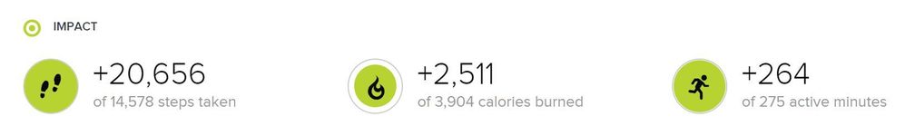

I'm having this regularly. I have an iphone 6s with ios 11.0.2 and the latest updated firmware for my fitbit charge 2 as of 10/7/2017. Today I did a 7+ mile hike and it stopped recording my steps and track a bit more than halfway through--- because this has been an ongoing problem since the ios 11 update I simultaneously recorded this activity in Strava and it worked perfectly. Interestingly enough during the activity the steps were accurately counting - i looked at the screen and saw 20k+ steps at one point. But when I sync'd it, the steps went down to 13K (my iphone shows 20k+). this is really getting annoying. I've force-quit and re-started the app, restarted my phone, cleared network settings, deleted and re-paired the bluetooth connection, and even wiped & restored factory settings on my iphone. This was happening both previous and prior to the latest firmware update on the fitbit charge 2 (but only since ios 11). I started tracking the activity from the fitbit.

How is this possible?? I knew I wasn't crazy - https://www.fitbit.com/activities/exercise/10293376257

Sorry @niconyc, you will need to be more descriptive or post a screen shot since we do not have access to your Fitbit account

Hi Rich- I did post a screen shot showing my activity added 20k steps out of 14k total for this day. Not sure why the screenshot isn't appearing! Sorry!
