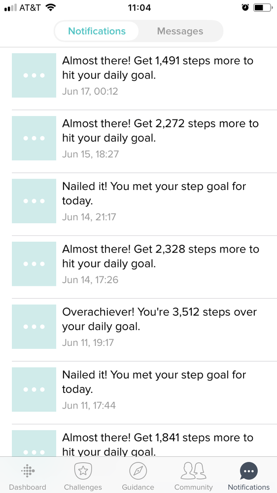

Which notices are you talking about? Could you share a screenshot or picture of them?

The notices are from the Fitbit app on my phone (IOS). Any new ones are not in the Notification list of the app. This list has not updated since June. I turned notifications off for fitbit in the app & in my phone settings, waited a bit & turned them back on - no change.

Here is a screenshot:
