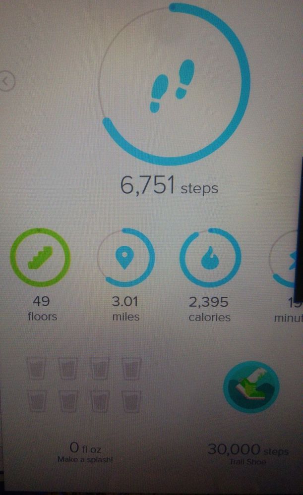

These are pictures from the 3rd attempt to sync/capture the tracker reaching 10k steps on Monday
tracker and dashboard before sync (3rd time of the day where tracker was 10K+ but sync reset to a lower value)
after sync
Hello @roch321, thanks for coming back and providing the pictures showing what's happening.
I'd recommend trying what I suggested here about removing your Charge 3 from the Bluetooth settings and pair it again. Before doing so, please manually reboot your device. From the clock face, swipe to Settings and tap Reboot Device
Give this a go and let me know if the issue persists.
