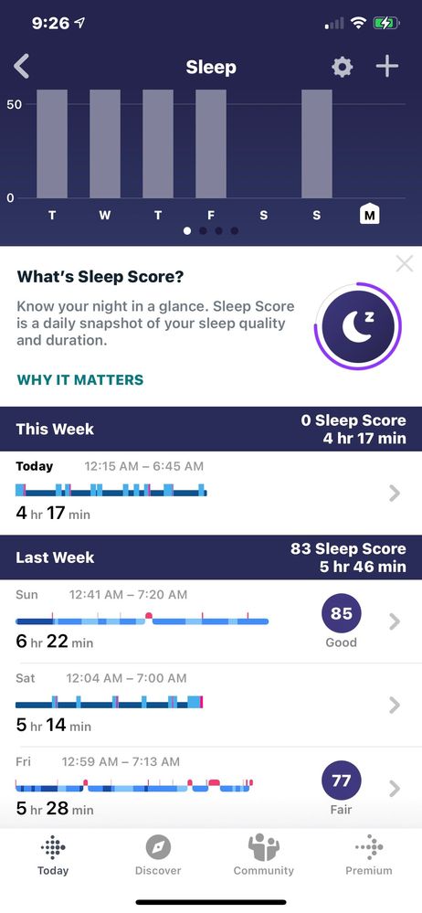

I rarely ever have issues with my sleep record.  Suddenly I have 2 nights with bad presentation.  No usual breakdown, you cannot change the total time no matter what you enter.  Is there an issue or change in process recently?

Thank you for the information. At this time, I'd like to ask if you can provide more information about the inconvenience by responding to the questions below:
  • Is your Charge 3 not recording your entire sleep activity?
  • What do you mean by breakdown? Are you referring to your sleep score breakdown?
  • Are you receiving an error when you try to edit your sleep log?
If possible, it would be great if you can attach some screenshots showing the discrepancies so we can further look into this inconvenience and provide proper information. To learn about how to attach images, please check here

I'm sorry for any inconvenience and thank you for taking the time to report this matter. I'd like to let you know that there was an inconvenience affecting health metrics and sleep, but I think it should be resolved by now. If this is not the case, please let me know.

Thanks, I am so glad.  My past sleep issues seem to have been fixed.  I also noticed my watch was pretty snug on my arm..  I had changed the band the night of the 1st bad report.  It was still tight on the 2nd one too.  I loosened it and figured, after all sleep reports were good, that it was why.
But whatever did it, I’m so glad that appears to be over.
