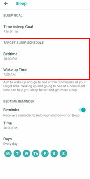

 What are the simplified sleep records? How do I change my start sleep time, and my awake time using the app. Been trying that forever, and it always says I can't. I have the app on Android Samsung.
@mrzocor1 Nice to see you back. The simplified records, are the one that only show you if you were asleep or awake, it doesn't show the sleep stages.
When trying to edit your sleep plan, do you receive an error message?
See you around
 It just says it can't set that time., I don't even know if I am trying to set it in the right place or not. I click on the area where it gives the amount of sleep I had. for that night. The spot that has the little plus sign next to it.

It seems that you are on the right spot, if you followed these instructions. :
  1. Tap the Today tab
    , then tap the sleep tile
  2. Tap the gear icon in the top right.
  3. Set or edit your targets. To remove a target, tap the three dots in the top right.
  4. Tap Done.

@mrzocor1 Hi there.
To edit your start sleep time and awake time, follow the instructions mentioned above by using your Fitbit app in your Android phone. (Check the screenshot below)

I have an android tablet. Samsung. Does that make any difference? That is where it wouldn't let me change it. It keeps saying it can't complete the change, or something like that.
@mrzocor1 Thank you for getting back.
In this case, let's try the following steps:
- Log out from the Fitbit app
- Clear the app cache if you haven't done so
- Restart your phone
- Log back in and try to change it
May I know the app version you have installed on the tablet?
