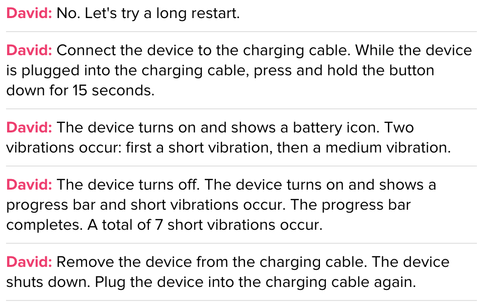

@sunshine122 Here's something the Fitbit service talked to me about. Maybe this might help?
Best Answer04-21-2019 15:21
04-21-2019 15:21
Thanks , that did work when I held button down for some time. Interesting that my steps did track even with a black screen. All is good
