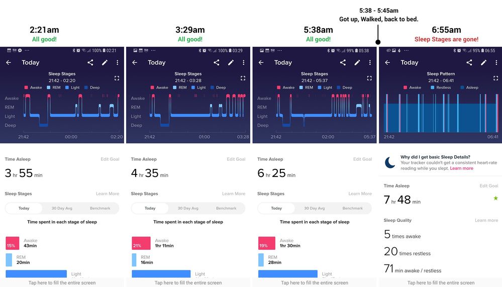

Adding a bit of visualization:
I have taken some screenshots from a restless night that I had (took the opportunity 🙂 ),
and this confirmed my own points in my previous post.
It seems that the sleep stages disappeared after I woke and walk for few minutes before heading back to bed for another hour.
* I will try the suggestion on turning off the 'All day sync', which if true, may be connected to the sync sleep data before heart data as I mentioned before. Sleep stages disappearing
