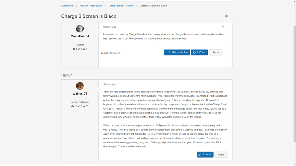

I have tried to reset my Charge 3 as described in a post as well as change the face screen in the app but neither has resolved the issue. The device is still tracking but I cannot see the screen.

Yep, the Fitbit Community apparently is only open if you agree with their official responses. The TLDR is: There is a recognized design defect with the Charge 3 & 4 screen (same component in both). Failure mode is a gradual dimming to black around 13 months out. Support will offer you a promo code if you make enough noise, which will end up being about $5 off the current price of a new Charge 4. You can get a new screen from Aliexpress for about $11. Fix is moderately technical. Search Youtube for "Fitbit Charge 3 Screen Repair Replacement". My screen is back to bright and readable. When it goes again in a year I'll probably buy Apple. No more Fitbit for me.

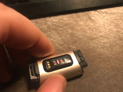

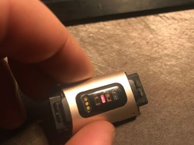

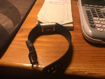

05-28-2021 11:52
Photos for proof.
Where is this device damaged? I pressed in on the sensors and moisture bubbled out of it around the black part. Shouldn't that be sealed?

Nick, so it sounds like your leakage is around the sensor/charge module rather than the display. There's a great teardown on iFixit. that shows that module fitment. The author of that article indicates that module is molded into the case so it may not be sealed with the same adhesive.
I saw your notes on how careful you are around water. I'm just the opposite - wearing it in the shower, swimming, rain and all. I've never seen evidence of water infiltration or condensation. Seems like spotty manufacturing SOPs allowing variable quality in assembled product - as opposed to the black screens which is a design criteria defect.

Yeah, I've already got that one bookmarked, actually. That's my go-to site.
So basically there's defective screens on some that causes the screens to fade out over time, and on others, improper seals causing it to get water damaged when it's advertised as water resistant.
I originally looked into the black screen issue because my screen went black and the device only vibrated, de-synced, unpaired, and wouldn't restart or long restart, which I've found many others have encountered.
I then found out it mysteriously had water damage, too, which others have also dealt with.
Both aren't new issues or are unheard of and uncommon, and aren't the fault of the end-user.
