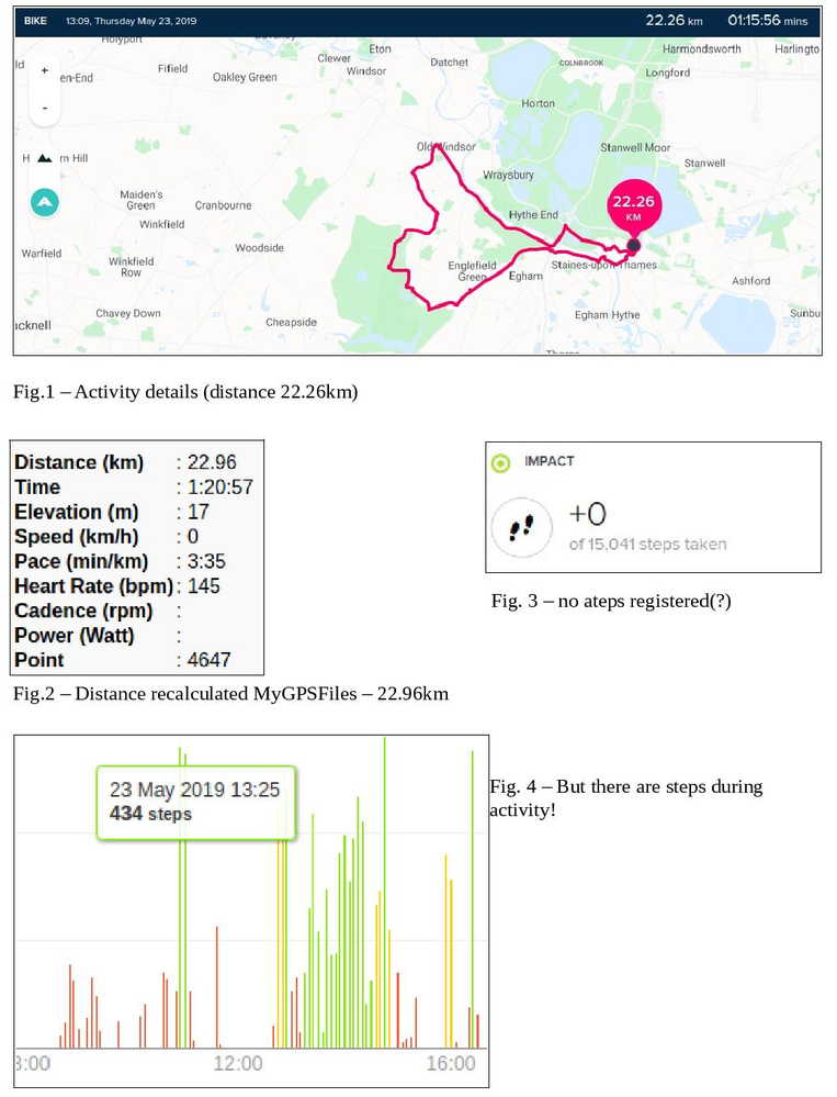

This ride was tracked with Ionic. One thing - the distance is wrong. The same TCX uploaded to the MyGPSFiles gives a distance of 22.96km while Fitbit shows less 22.26km. Now, the Impact field indeed shows 0 however if you look at the overall steps graph, there are plenty of steps during that ride registered and they do contribute to the daily steps count. Now, there may be two valid explanations.
1) Bug on the dashboard and always showing 0
2) Fitbit stopped counting steps during a bike ride (very quiet update?) but past bike rides would not change data (something to be verified)
Until verified, I vote for option number one - a bug in the dashboard.
Edit: just noticed that even time doesn't match and looking at timestamps, MyGPSFiles is right.
@AdamH0 This is the bug on the dashboard. I took recent ride (about 2 weeks ago) recorded with Charge 2 (Connected GPS, same as Charge 3). Results below:
This test in fact is way better as I didn't wear the device at all except the time I rode the bike. My bike ride added 4,5k steps to the daily total. Showing "Impact" as 0 must be a bug then. The good thing is that this time the time matches.
