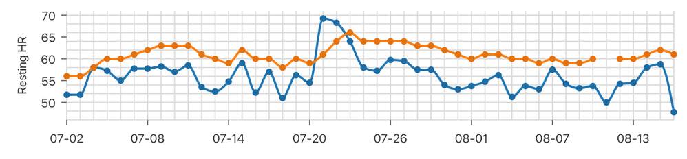

I love my FitBit (Charge 2 and now Ionic), but I've struggled with the resting heart rate calculation. It's something I check every morning as a proxy for my overall fitness/health, and it's often the case that when I look at the graph of my overnight heart rate, if I draw an imaginary line through the midpoint of that graph, the calculated resting heart rate is well above what I can see the average is. And the difference isn't consistent -- sometimes the difference between the graph values and the RHR is larger than at other times. It's pretty frustrating!
So I wrote an app to calculate my RHR directly so I could compare it to the FitBit values. My default algorithm calculates the minimum average heart rate over any one-hour period during the day, and I've also experimented with shorter and longer periods for the average.
What I found is that the FitBit RHR is usually 4-6 beats higher than the minimum one-hour average. There also appears to be a multi-day "damping" effect -- the FitBit algorithm won't respond quickly to changes in resting heart rate from one day to the next. I have data going back over almost a year and a half, and it doesn't look like the FitBit RHR algorithm has changed dramatically during that time.
If you want to try out the app yourself you can. To get access to the intraday HR data, you need to register the app as a "personal" app; there are instructions in the app. I've tried to make the instructions on how to do this as simple and straightforward as possible. It will work in a browser or on mobile.
If you run into issues with the app, or have feedback, there's contact info in the app under "About" -- please feel free to send me an e-mail.
The app also helps you to download your raw HR data in CSV format if you want to look at the raw data yourself.
Here's a sample graph. Orange is FitBit's RHR, blue is the minimum one-hour average. Don't remember what caused the bit spike on 7/20 -- probably I got sick. But you can see how the FitBit value 'lags' behind the changes in the underlying resting HR.
