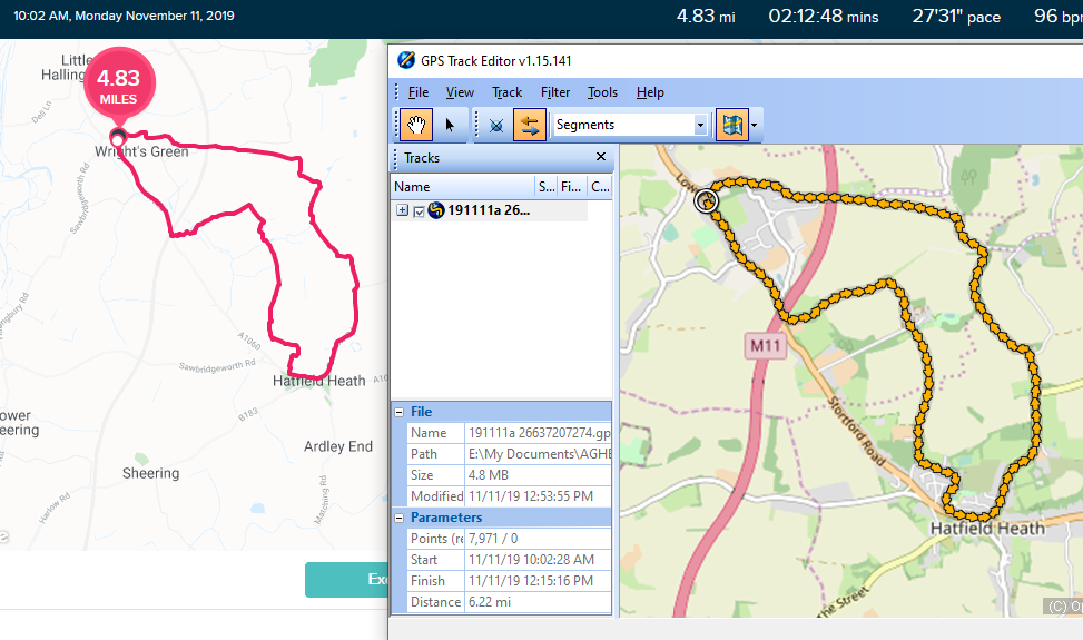

I have the same problem with walks.  My Fitbit is connected to my 'phone and the track shows correctly on the website.  The distance shown on today's walk is 4.83mi, but if I download the track and put it into a track editor that shows 6.22mi.
The stride length is set to calculate automatically and shows 28.3ins.  On this walk 13,470 steps were recorded which calculates out to 6.02mi.  So that is also inconsistent.
I have added a screen shot of my computer showing the walk on the Fitbit website overlaid with the GPX editor display of the same walk.  This shows Fitbit's 4.83mi and (at the bottom) the calculated 6,22mi
