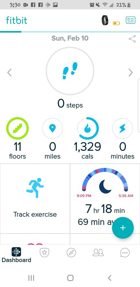

Hello! I just noticed my Fitbit charge2 did not register steps for three days, and then picked up tracking again. It measured/tracked stairs etc, but not steps.

Hello! Thank you for your response 🙂
I restarted as you suggested but the steps for the missing days did not appear.
Attached are snapshots of the days so you can see what I am referencing. I just noticed that each day has the same count for floors, calories, etc.. that is odd?
I am in a walking challenge so I check my tracks constantly and know that for those days I had at least 10,000 steps..

Thanks for the pictures @SunsetRunner, and for trying to restart your Charge 2 as I suggested. Let me suggest you something else, could you please refresh the app? I mean, log out from your Fitbit account and then log back in, then sync your Charge 2 again. If the previous steps won't show, you have the option to manually add those steps, but they won't count towards your challenge.
Give it a shot and let me know if that works!
