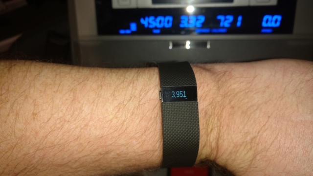

As you can see above, 3.32 miles on treadmill in 45 minutes, no holding handrails and I only get 3,951 steps...

Best AnswerYes if i look at yhe above pictures, and try to mske sense the rest, it looks like something is preventing the fitbit from counting steps. Does ypir Fitbit count correctly on free runs? And have ypu done a step count test while on the treadmill?
I as well ss many others have never had a problem with the step count on a treadmill, true i only have used them while staying in motels.
Are the arms moving naturally?
Best AnswerJust a thought, but it might be worth trying a separate pedometer while on the treadmill. There is a difference between moving on the treadmill and moving on the ground. I believe it is more likely that the difference is the result of that rather than the result of the fitbit working differently on a treadmill. Testing the fitbit simulataneously against a simple step tracker might be useful.
Maybe a restart is needed of your tracker.
Good thought @SunsetRunner, a cheaper way would be to start the tracking function run 100 or more steps while counting them in the head. Stop running and look at the current step count.
