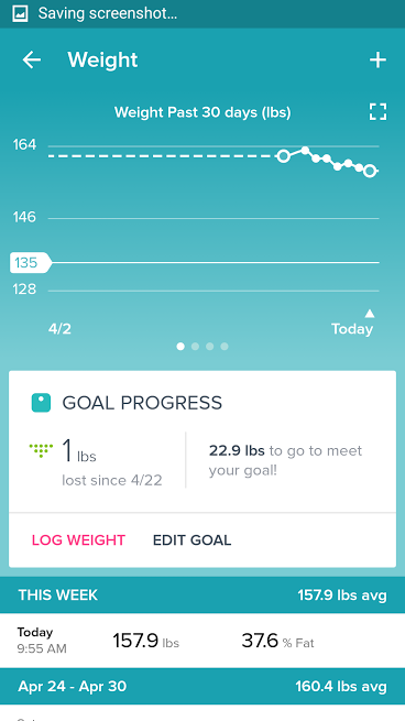

My Weight progress is wrong on the app. It's correct on the website, and even after weeks of forcing it to sync, it's not syncing. The very first time I entered my starting weight, it was wrong. I got the Aria about a day later, and started to log my weight that way since.
On the website, it is correct because I deleted the very first entry (and eventually it calculated my weight loss progress correctly.
On the app, it either shows two dashes or says the wrong weight progress calculation based on the very first (wrong) weight entry. I've deleted the wrong weight entry from the app as well, and it doesn't show anymore. But it still calculates it from the first entry.

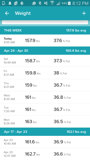

Thanks! So I made sure the Fitbit app I am running is the most updated and
also cleared cache/data. Still showing the wrong goal progress. Here are
screenshots. As you can see, the weight progress is based on a 4/22 entry
that has been deleted due to inaccuracy (originally, 159.7 lbs). It should be based on the 4/23 entry which was recorded using the Aria scale, which shows 162.7 lbs.
I want it to show my actual weight loss, which is closer to 5 lbs than 1 lb!

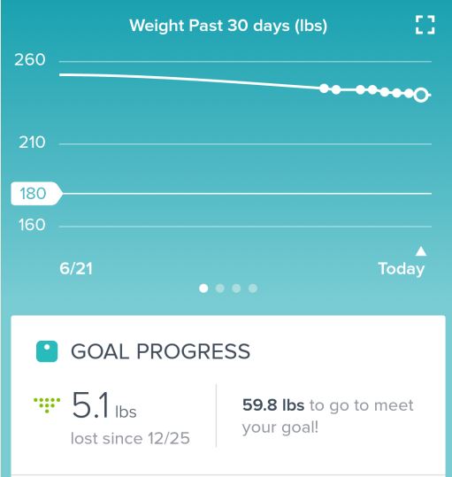

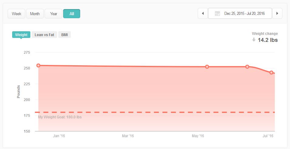

I'm also experiencing the same issue.  The web dashboard shows the correct movement for "Weight Change", however the app is off by almost 10 lbs.  I followed the steps outlined earlier for correcting the issue, but it is still wrong.  Here are the steps I did:
  • Logged out of FitBit App
  • Closed the app through task manager
  • Settings > Applications > Application manager > FitBit > Storage > Clear Data
  • Settings > Applications > Application manager > FitBit > Storage > Clear Cache
  • Started FitBit App
  • Logged In
Once logged in, the Goal Progress was still wrong.  To take matters further, I completely uninstalled the app and re-installed it.  When I logged in, the issue was still there.
I am using a Samsung Galaxy 5, running Android 6.0 (Marshmellow) with Verizon as my carrier.
