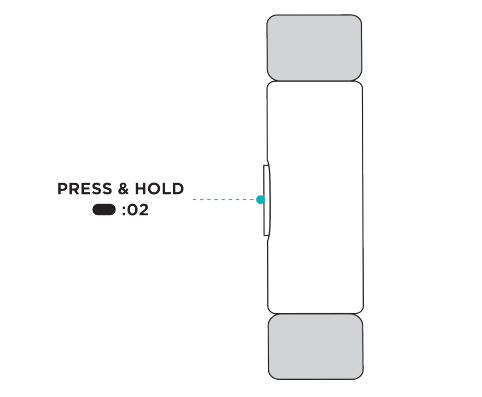

Check quick settings
Press and hold the button on Inspire HR for a faster way to access certain settings.
Tap a setting to turn it on or off. When you turn off the setting, the icon appears dim
