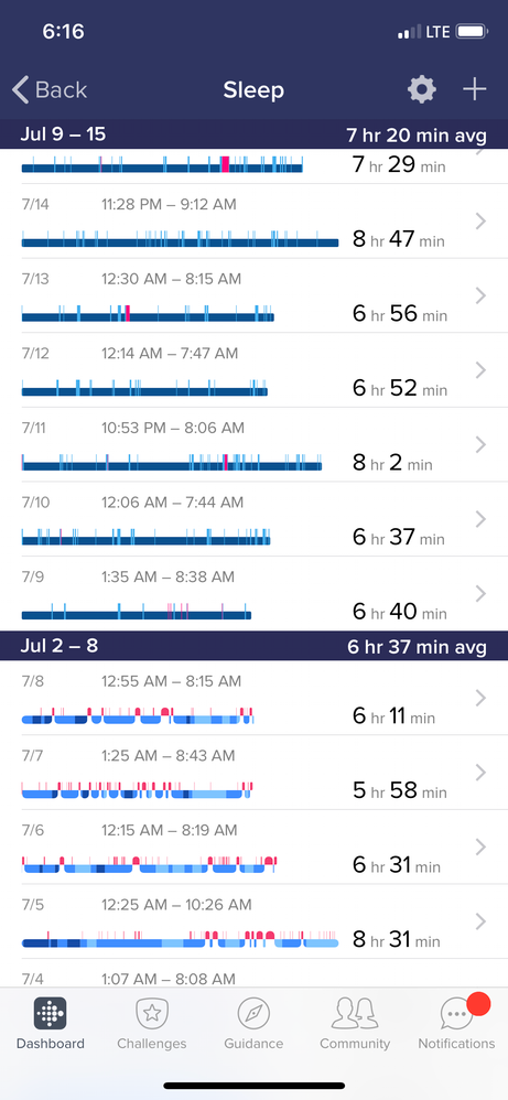

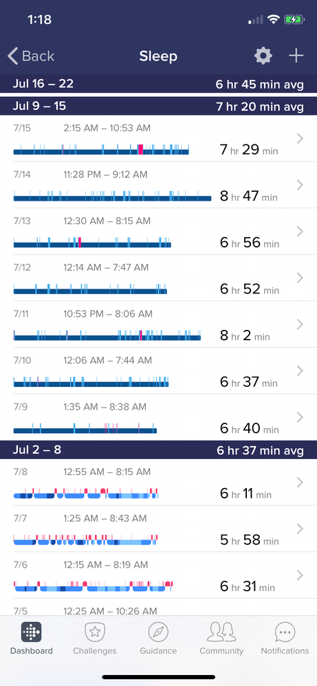

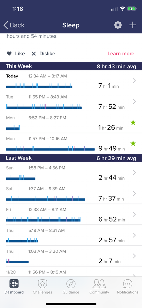

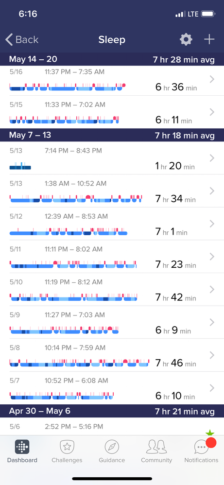

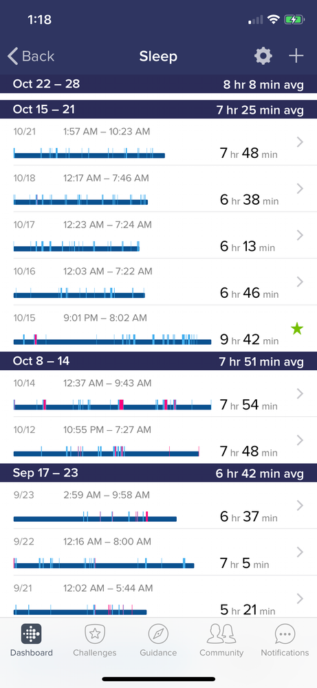

@Nlrousseau It seems it stopped recognizing sleep stages after July 8. Would you happen to remember if there was any update? Also, does your versa track your heartrate properly? Can you please attach some screenshots for the time period before July 8 and after?
Marrrmaduke | Canada
Charge HR, Blaze, Charge 2, Charge 3, Inspire HR, Versa Lite, Versa SE, Aria

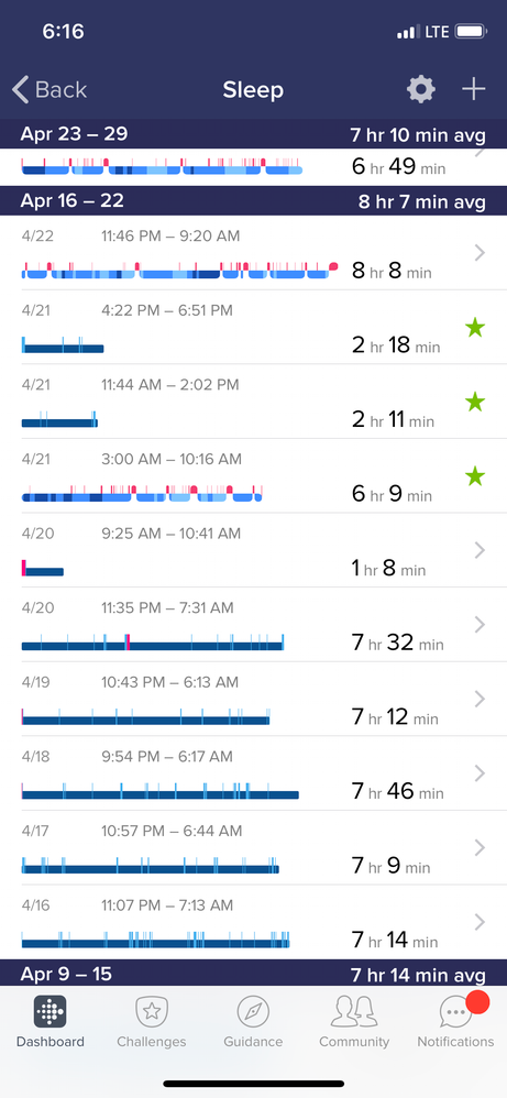

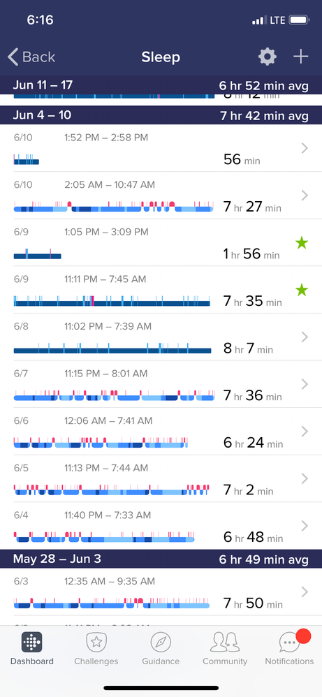

No big change on or around that time. Here are some pictures from when it worked properly. From when I changed from Alta to Versa

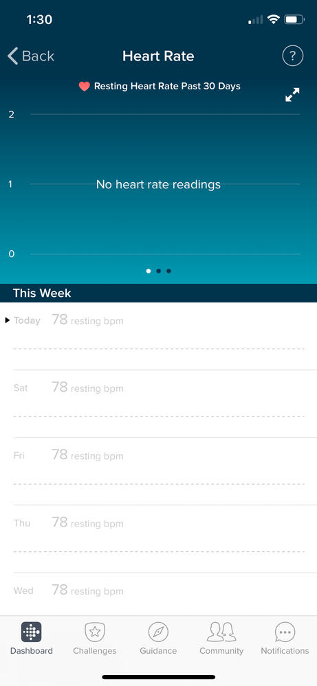

@Nlrousseau Thanks but I mean heartrate recording for the problematic and good nights! You can take a screenshot of the heartrate measurements chart displayed in the Fitbit mobile app. 😊
This screen?
