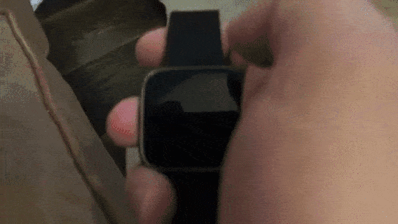

2 days ago I began having an issue where my Fitbit Versa's colors would start out normal, but then invert after a second or two.
I also noticed that if I switched screens recently, I could see my previous screens with reduced opacity. Image and video below.

Okay, so I did a factory reset on the Versa and disconnected it from my iPhone's paired devices. Then I restored, reconfigured and updated the tracker. The issue is still there.
Actually, this issue persisted throughout the process. Even when the device was completely in factory mode and scrolling through.
Took another video essentially showing the same thing but on the setup screen (below in the form of an animated gif).

I've tried:
- Changing the watch face (issue occurs both on the watch face and on other screens, like when I'm scrolling through my apps)
- Resetting the Versa by holding the left and bottom right buttons until the Fitbit logo appears
- Updating the Versa (I've been on the latest version, v33.1.30)
- Making sure my Fitbit app (iOS, latest version) is up to date (Fitbit for iOS v2.88)
I have already performed a hard reset, a restore, and checked multiple clock faces, including the default Fitbit face. The issue persists in all scenarios.
Best AnswerHi, by now it's time to contact Customer Support about your problem, cause it seems to be a hardware problem.
Best AnswerYeah, I guess it is.
I'm not the only one having it though. Several people in this thread seem to have reported it as well.

Thanks @EdsonFitbit, yeah I contacted support directly yesterday and I guess it seems like a hardware issue. Fortunately I'm still in warranty. I hope all the people in that other thread that I linked also contacted support though!

Best Answer@Danielsan91 I am afraid this is a hardware issue. Probably. You can attempt factory reset (restoring trackers to factory defaults), but my best gut feeling is the best would be to contact Customer Support. Did you purchase it/ are reside in European Union? If yes, you should have 2 year warranty, I believe. 😞 Sorry, I couldnt be more helpful.
Best AnswerFor me, this was almost certainly a hardware issue. Restoring to factory defaults as @Marrrmaduke suggested is worth a go, but it never worked for me.
Either way it's time to open a support ticket with Fitbit to see if you're within warranty or if they're willing to make an exception for a hardware issue where you're not at fault.

Best AnswerI had the same problem with my versa and I stopped using it altogether. The screen would dim then the colours would invert and sometimes you would be able to see previous actions on the screen. I was thinking that I should probably get the screen replaced but I haven't done that yet.
