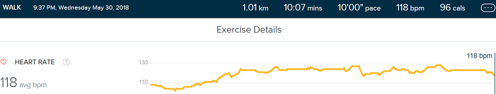

So I compared the Fitbit Versa with my old trusty Fitbit Blaze on the same route to see if there is a difference.
First* I took the Blaze on a small elliptical route near my home. It took merely 5-10 seconds for it to connect to my phone and get a lock on the GPS. Then throughout the 10 minute activity it did not lose connection with my phone, which happens to be a Google Pixel 2 running Android 8.1.0. Here is a screenshot for verification.
Clearly, it was a 0.90 km walk for about 10 minutes.

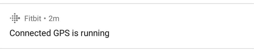

The phone also showed me that connected GPS was infact indeed running, in my notifications.This is a screenshot from my phone.Anyway, here is the proof of the miserable failure!

Okay. So I did a more thorough test that will help prove to any Fitbit community council member or Fitbit forum moderator that this is infact the FAULT OF THE VERSA and not the phone!
