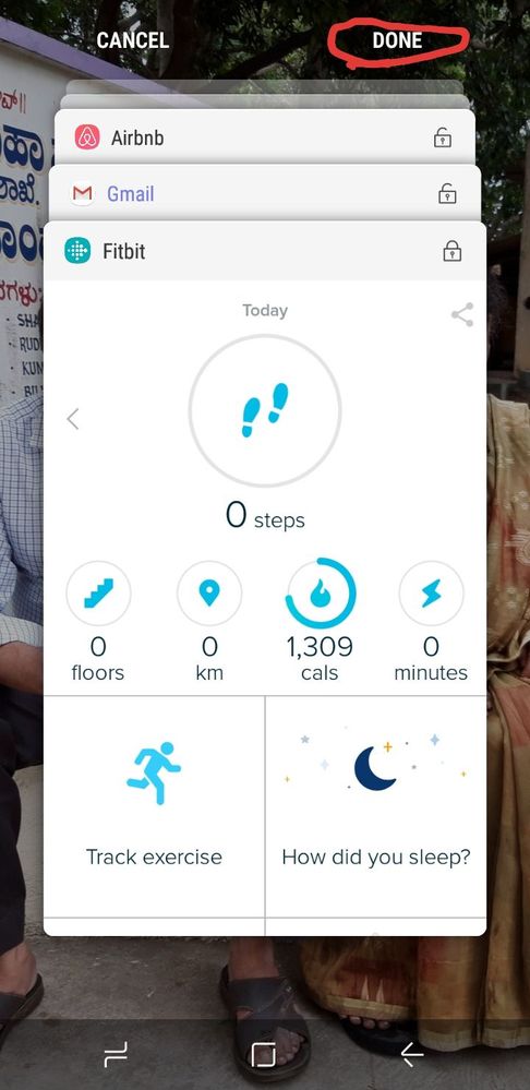

I don't no if this works for me . Will try tomorrow on my run. I'm using samsung android phone with oreo(8.0).
But I would like to share how to lock the App .. this is how it looks in my android device I do not have that padlock mentioned instead I have tab expanded which shows the App lock feature
I'm able to Lock the Apps.
Meanwhile please try this work around & let us know this works for others users

@Srikanta thanks for showing the locking feature on Samsung. One more thing, also please make sure Fitbit mobile app in not being optimized by Android. In battery settings under optimization, Fitbit app should be marked as not optimized.
