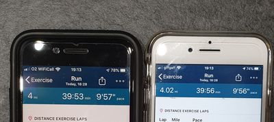

Today I borrowed my sons IPhone 8 uninstalled fitbit from my Android, and linked my Versa to his IPhone.
Then tonight me and the wife have just done out 4 mile route and guess what! It's spot on on my watch exactly 4.00miles on my wife's 4.02miles so near as doesn't matter.
 both IPhone 8 my lads black one is running 3.10 my wife's hasn't updated yet so is still 3.9.
It is without doubt an Android app problem.
I have Re installed back onto my S9 and Re paired the watch. At the moment it is only running V3.8 downloaded from the play store about 1 hour ago. Says no updates available even though it was on 3.9.1 previously.
Either way it works perfectly on IOS but is junk on Android.

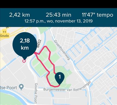

Took a walk this afternoon. Track distance is correct. Summary isn't.
Android phone fitbit version 3.9.
problem has nothing to do with stride length or watch. It’s the app on the android phone.

 it’s all in the apps. There’s nothing wrong with the device, phone or gps. Check out the export file. look at the TCX-file.
Yesterday I had a 5 km run. The app on the device said 4 km. And on the phone said 4 km.
On Runkeeper it said 4 km. BUT when I “edited” (doing nothing) Runkeeper changed it automatically to 5km and put the 1km signs correct.
today I’m gonna prove myself by using my own selfmade app and prove that it will calculate it correctly.

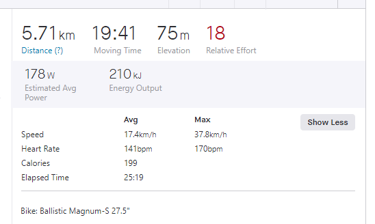

Here is my last bike ride uploaded (automatically) to Strava (I have enabled the Fitbit -> Strava auto sync).
This 1st screenshot is the original ride, as it was auto-synced to Strava:
This 2nd screenshot is the same ride, after I clicked on the "distance (?)" link (on Strava.com )
Now maybe we should also consider that Bike rides do not even use the Stride length, right ?
I kind of think / remember that the "changes" are bigger when Stride is also taken in as a factor (meaning in Walk, Run activities).
