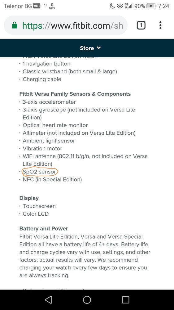

2. What's it by now, a couple years since Fitbit first (supposedly) put SPO2 sensors into Ionic, Versa, and others, yet still not a hint of if and whether they will actually work? It's incredibly useful information, both on how you are doing when exercising, and an indication that perhaps sleep apnea is affecting your O2 levels - so what's the problem, and if or when they will ever work?

The 2nd frustration is the SPO2 capability. Does it actually exist or was it true vaporware? As a long time software developer, I've encountered plenty of vaporware in my life. But after the Ionic never got its SPO2 sensing, you'd think they would stop announcing the feature in newer products. We truly have no way to know if it was anything beyond pure vapor.

Continue to advertise something that's gone

SpO2 readings were and probably are a big selling point. At this point some honest answers would be nice.

on the “SPO2” .... ITS A SHAME the way fitbit is handling this.
