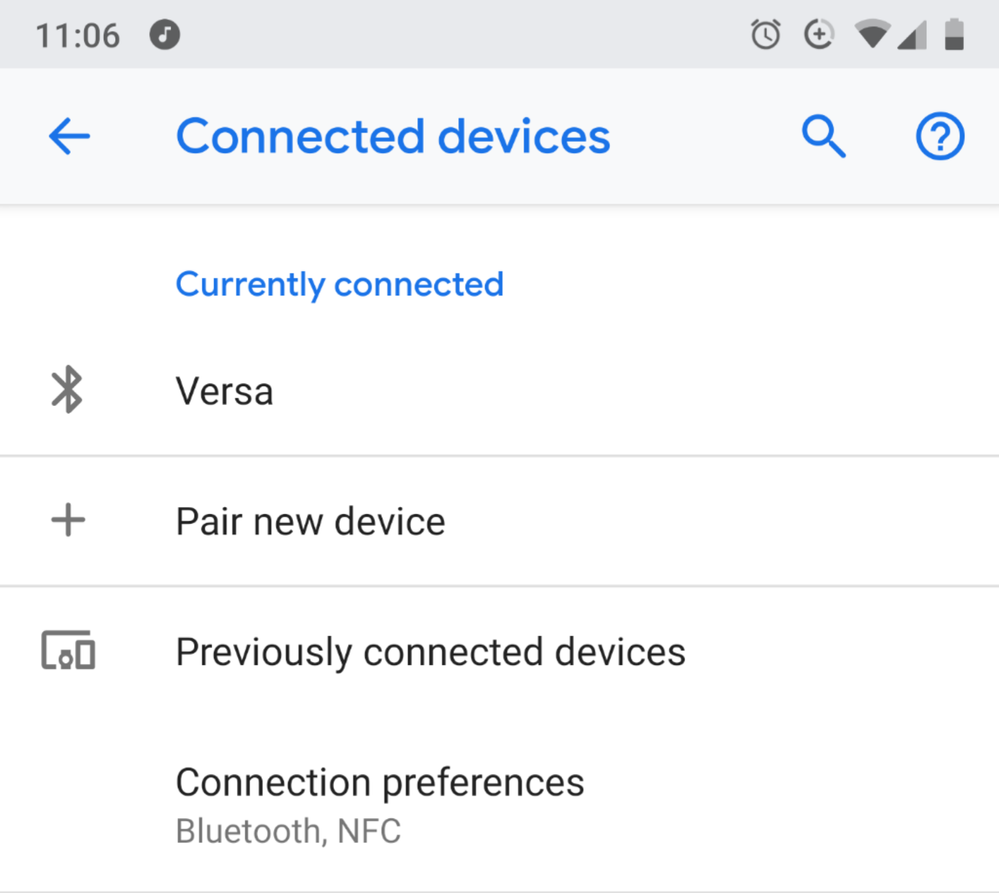

I don't know if it's the same for iOS as Android but on my phone (on Android Pie) my Versa now appears as a connected device in Bluetooth settings. Before it did not appear as a connected device and I had all those "connecting" issues. I haven't had anymore issues since I got it to actually connect. That may be a good way to see if your Versa is not properly connected to your phone. Screenshot_20180822-110632.png
