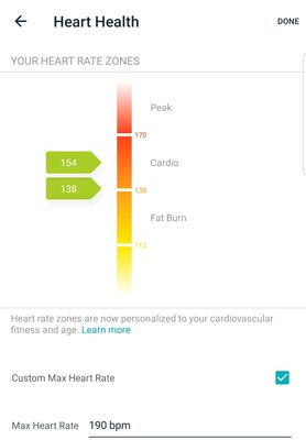

As others have said, you can set a custom heart rate alert zone in the app under heart rate settings > heart health > custom zone. Apparently this should override the default zones.

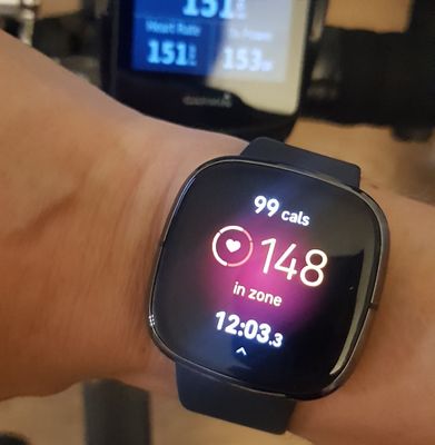

@RHaas so I have tried to use a custom heart rate zone for an indoor bike ride. I set it up to my low-aerobic zone(138-154):
It works as expected however there are no notifications when you enter or exit the zone. So in fact, you need to look at your HR to see whether you are within the specified range. The regular HR zones (fat burn, cardio, peaks) don't show when you use the custom zone. For the custom zone, there is no vibration. It's just this:
So it's either "below zone", "in zone" or "above zone". So it kind of does what you want. Just set up the zone you want to be in. You will have to look at HR from time to time as the watch will not notify you when you leave or enter the zone.
