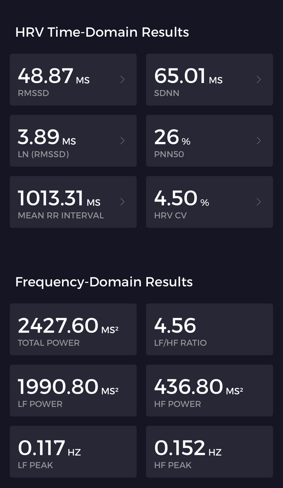

@Compendium and @Shelly0872 these are some the metrics, direct from the heart, required to calculate HRV.
Sorry Fitbit says the screenshot contains numbers that are forbidden so I can’t post the screen shot 😞
01-29-2023 16:28
01-29-2023 16:28
@Compendium and @Shelly0872 I had to change the name of the screenshot so it didn't contain numbers. These are 12 of the metrics used to calculate HRV.

@SallyOz mind that overnight HRV is different from what EliteHRV shows you (you comparing apples to oranges) due to vastly different time domain. The morning HRV in short time domain is a different result. On the other hand, EliteHRV isn't suited for overnight measurement.
The metrics above are not used to calculate HRV. What is used are R-R intervals (because this is all you need). Metrics you see in EliteHRV are result of running different computations on R-R intervals. One thing you don't see here (but you could export from H10) are those R-R intervals.

@SallyOz HRV isn't complicated to compute. If you get R-R intervals out you can calculate RMSSD and SDNN in Excel. These are not some magic formulas but well-known statistical methods. What is complicated is to tell whether there are signal artefacts. Smoothing data too much may result in lower HRV while not smoothing at all will result in huge fluctuations. Both methods are susceptible to large changes. It means that with different datasets, you need to work differently. That's why HRV won't be the same on other systems. You need to process the data first. The only thing that really counts is R-R intervals as this is the only thing that "comes from your heart". Everything else is processing which may vary on different systems. On Fitbit, with the EDA app, you can check your HRV on the spot in 2 minutes domain. Have you tried that? You can literally compare readings side-by-side.
I did 3 tests of HRV using three different devices in the time domain. It's important to understand what you're looking at. Fitbit works using RMSSD. EliteHRV uses both methods (RMSSD, SDNN) but the result is a score. The path is readings->filtering->method->output. Filtering and method may be different through various systems. If I try to check my HRV using Garmin paired with H10 and EliteHRV paired to the same strap, measure at the same time and very same time domain I may get the same results but it's not certain. R-R intervals will be the same but filtering the input and applied method may differ. I just did a such test and Fitbit has me 76ms, while EliteHRV (H10) is 61ms and Garmin (H10) 53ms. All three tests are done in a 2min time domain (I match that to Fitbit's EDA app). Which one then is correct? Two use H10 chest straps yet the results are different and ironically, Fitbit's reading came highest:
If you have EDA compatible watch, you can perform the such test yourself. Lots of data and numbers are great but it means nothing without understanding those numbers (and low HRV doesn't mean you'd be dead, that shows a lack of understanding of what HRV is, which means only your heart is closer to a metronome but it may mean anything).
