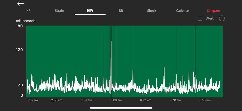

Some actual data from 3 devices during my sleep on 7/15
Fitbit HRV: 23 ms
Whoop strap 4.0: 30 ms
Frontier X2 chest strap: 23 ms (graph below)
And just now:
EliteHRV: 59 ms (Garmin HRM Pro chest strap / iPhone XS, 1:24pm my time)
I think the belief that Fitbit's HRV readings are inaccurate are more about comparing apples and oranges. As you can see from the graph, even while sleeping my HRV is bouncing around. So I think the question is more about what algorithm's being used, if you're awake, and what time period it's being smoothed over.
