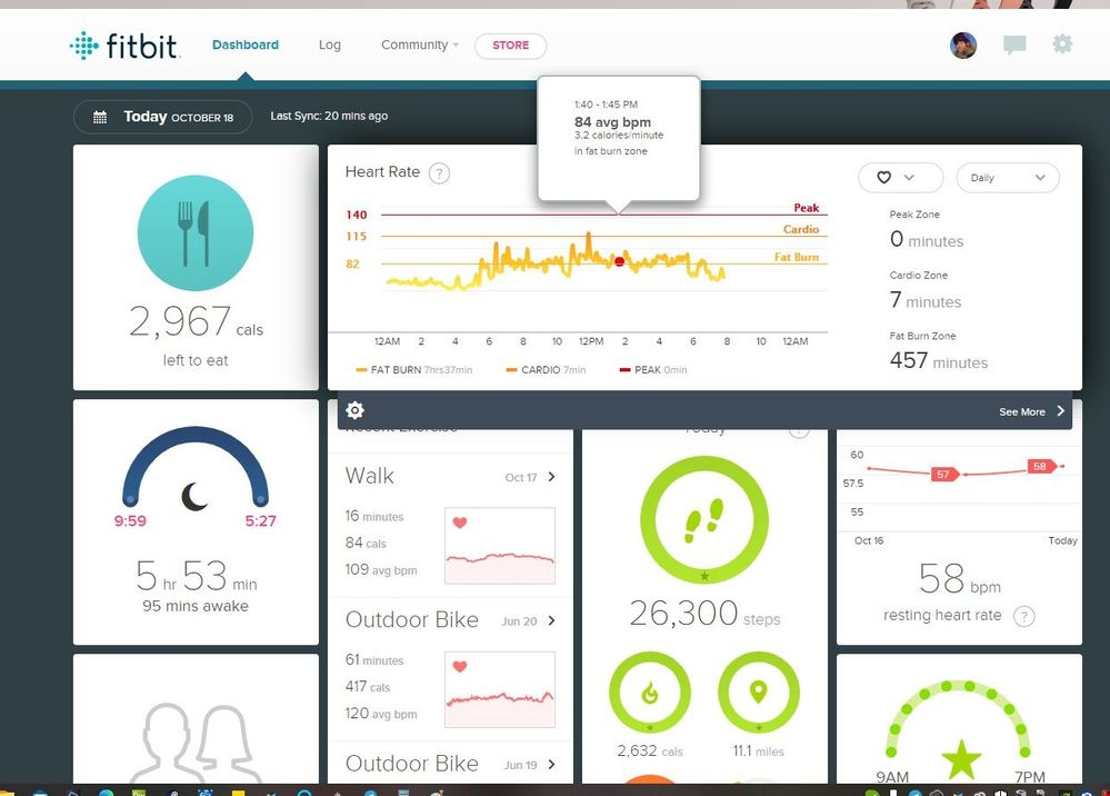

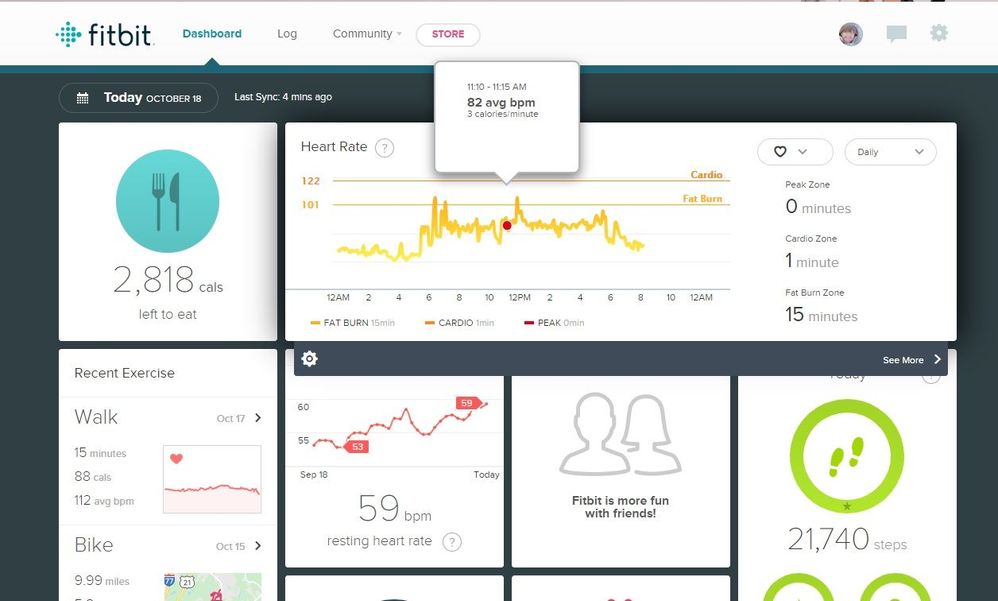

Hi, I purchased a Versa 2 this week on Prime day.  It has changed my Heart rate zones so it says my fatburning zone starts at 101 HR and my Cardio zone at 122.  I am 55 so the Charge 3 has always started it at 82 or 50% of Max HR and my cardio at 115 or 70% of Max HR at 55.  Here's screen prints showing the difference.  I'm wearing both trackers on different accounts to compare. Does anyone know why it would say the fat burning mode is so much higher on the Versa 2?  The screen shots below are my Versa, then my Charge 3 showing the Heart Rate Zones.  If you use the standard age formula the Charge 3 would be correct with my minutes in fatburning zone.  I am extremely active at work, i work on the Inbound line at an amazon warehouse taking up to 60 pound boxes off the line, then breaking them down quickly to 25 pounds and putting them in totes and must maintain at least 1 per minute rate or 60 minimum an hour.  Most stats are pretty similar, surprisingly.  My steps on the charge 3 are showing too high but that is because I forgot to change it to say dominant wrist, it thinks it's on my non dominant wrist but when i got the versa I moved it to my right arm.  The sleep stats are super close, the heart rate is close enough, just the heart rate zones are so much higher on the Versa 2.  I wondered why?  I was going to edit them to match but I was wondering why they would be that high.
Versa 2 Screen shot with my heart rate zones showing
Charge 3 zones showing.

I think this is due to a change from active minutes to active zone minutes that was introduced with the Charge 4 and has since rolled out to the Versa 2. This change included a different way of calculating heart rate zones. The old way was based just on our age but the new way also takes into account our resting heart rate to tailor them to our fitness levels. What many of us have found is that this change raises the threshold at which we reach the zones.
There's more on this at https://help.fitbit.com/articles/en_US/Help_article/1565.htm
