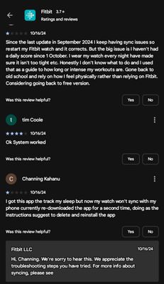

So many people are having the same problem it's not the watch, It's an app issue and they are working on it..at least we hope. I'm hoping once the app is updated our Fitbit watches will sync.
@Marylizzy1119 where's all the complaints from so many having the same issue? I just booted up another phone, logged on, and synced in under a minute.
@MarkMM the complaints were on the latest app reviews.
