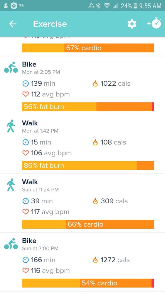

This is what my exercise tile looks like engaging bike mode, but the connected GPS didn't connect. I just go anyway and don't fuss with getting connected anymore. I use Samsung Health for actual miles.

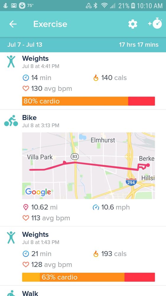

And this is how my exercise tile looks if connected GPS worked. I have a path near by, so it was straight out and straight back. You can click the exercise for more details and a better map.
