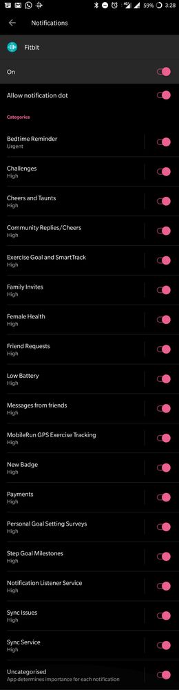

@Babji Redmi phones are known for terrible power management. They kill off background processes like crazy. Check this thread if it helps. Also make sure that all Fitbit notifications in your Phone Notifications Settings are set to High. Especially Notification Listener and Sync:
