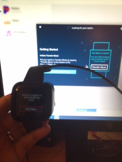

I appreciate your help. I followed your steps verbatim and got this far (which is where I get EACH time I try to load music, even though the desktop Fitbit app WILL sync with Versa):
Seems that Versa is ready to load music while PC app keeps ‘looking for watch.’
Versa says "use computer to start transferring" - Fitbit app says "Looking for watch"Versa says "use computer to start transferring" - Fitbit app says "Looking for watch"
