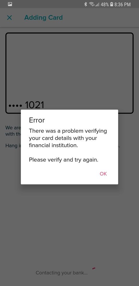

Attached is the screen shot requested.
Thanks for getting back and for the screenshot @Billster. Could you please tell me which card are you trying to add to your Versa, is it an American Express?

Yes.  It was American Express.

@Billster  I'm having this same problem with my Amex card.  I added US Bank and Capital One cards with no trouble.  Now, I repeatedly get this error message.  (Exact same screen message).  Contacted Support but haven't heard back from them.  Were you able to resolve your issue?  Is there some trick to set up with American Express?

@Billster  I figured it out!  Amex will only add if you turn off your wifi on your phone and do it over your cellular network.  Also, I made sure the address entered in Wallet was an exact match to the one Amex was using.  Amex had my zip code as zip+4.  I wasn't entering it that way.  I do believe the wifi was the root cause.
