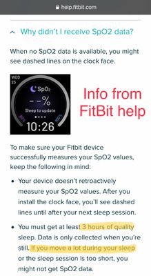

UPDATE: I did get a percent one morning. Now last night’s sleep was broken in chunks. I read in FitBit help it has to be a continuous “quality” sleep for a minimum of 3 hours.
SPO2 Clock Face help article

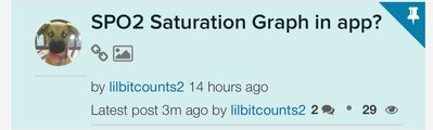

Found out more info in a reply to this post -
There will be a Health Metrics Dashboard in app coming soon and will be part of the Premium subscription. A 90 day free trial link is in the article.. This certainly looks like an exciting new feature, timely and useful as well. Click on the link above, there is a very thorough description.
