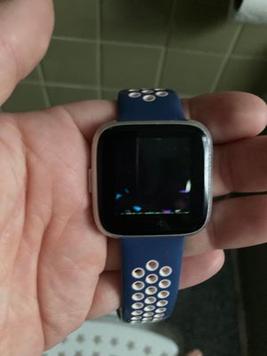

This is what my spo2 clock face looks like. I've set my watch up as a replacement. Uninstalled all other clock faces. I've reset it twice. I have checked to make sure all permissions were checked. I have contacted support and have gotten no where. My watch works just fine. I can change the clock face and it works as its supposed to. It seems to be an app issue.
