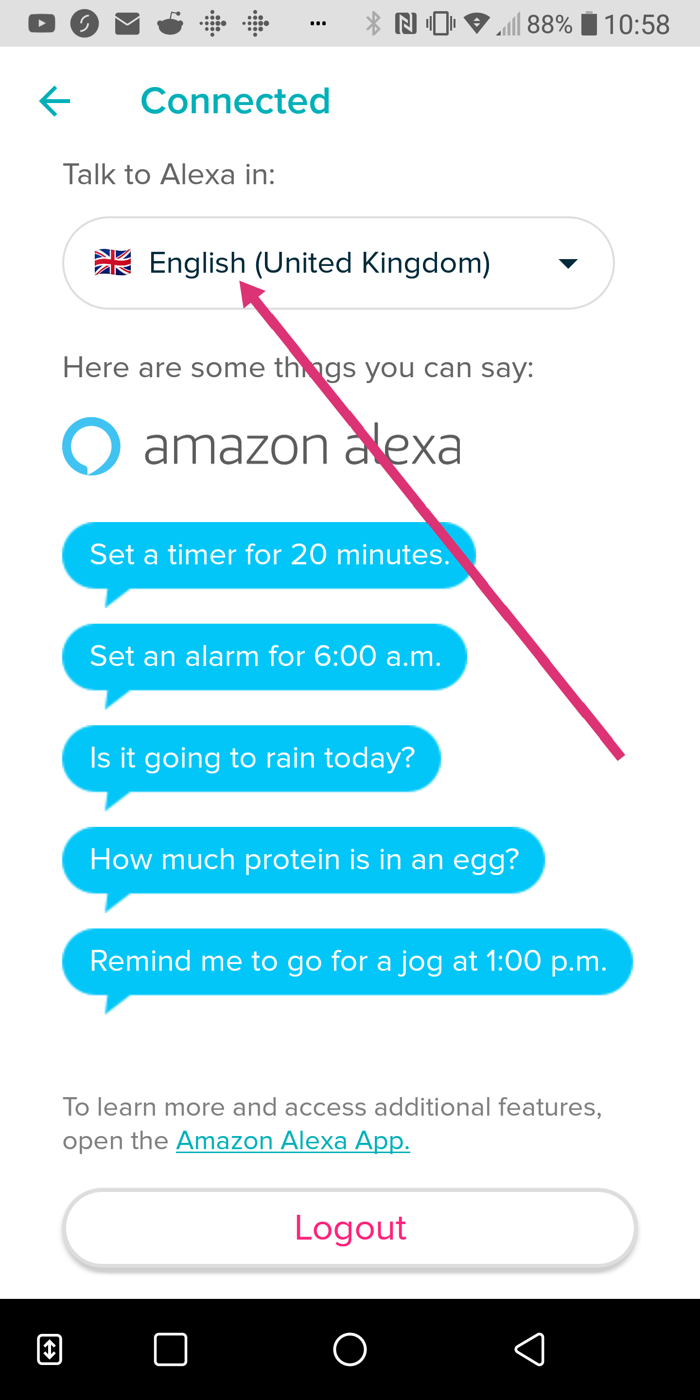

Hi @krisveldhuizen.
What happens if you change your location to Germany, but then go into the Alexa tile under your account and change the language under "talk to Alexa in"?

Hi @krisveldhuizen.

That was it! Thanks again. I'm happy with this as it is, but maybe you can help with a minor issue that has resulted from this;
I've set it to German with speaking language to English... the only thing is now that the prompts (like "ask a question" or "wake up!" after your alarm expires) are now in German. Same for French of course if I set it to French). Also, apps, such as Weather ("Wetter") and "Alarms ("Alarme") are in German now, as is the day of the week on my clockface. Is there some way to JUST have the location set to either country, but otherwise have the watch use English for everything else?

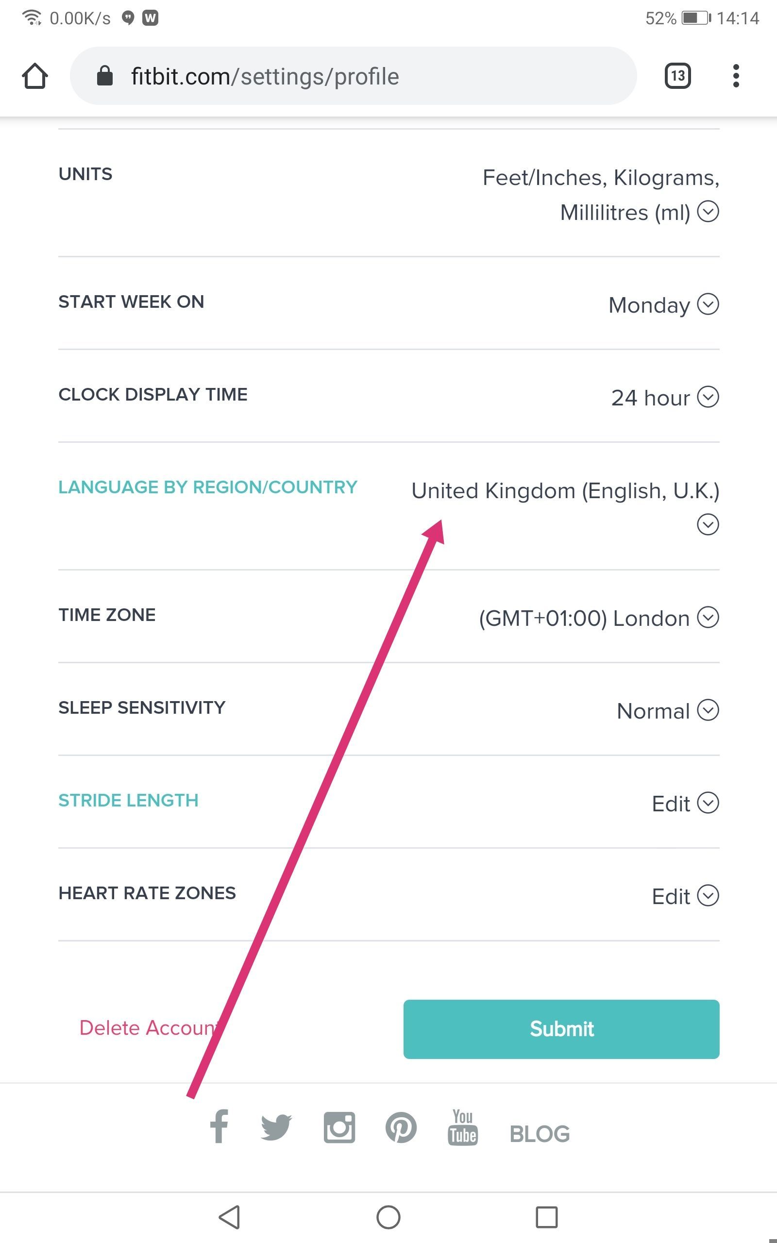

First of all I would start by restarting your Versa 2 by pressing and holding the button for 10 seconds, then sync again to see if this updates the language.
If not you can log into fitbit.com and then your Web dashboard, the settings cog on the right hand side and then settings. What country and languages are set in there? You can try playing around with them, but I'm not sure if doing so will put you back at square one again. If you do change anything in here, make sure to sync your fitbit again with your phone for the settings to take effect.

You did it! I'm entirely happy. Thanks again!
Excellent, we got there in the end 😁 Which part sorted it? The restart or the web settings language?
Community Council Member
Nathan | UK
Looking to get more sleep? Join the conversation on the Sleep better forum.
Sorry, just saw your question now. The web settings language did the trick. Thanks so much again!
