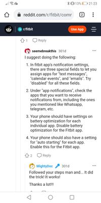

Did you do all the steps in the picture? As it's the apps battery optimization that is the problem it seems. I was having to clear data every single day on a brand new device was so close to sending it back for a refund. Fitbit really ought to stick a banner in the app to help all the people that have this issue with android phones. 🙄

Ok did it will see how it goes
