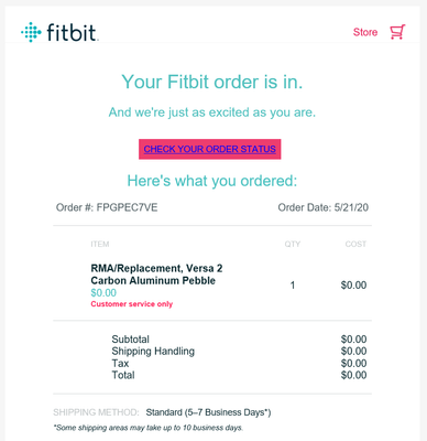

But customer support is awesome and came to the rescue!
After using Twitter @fitbitsupport I was able to have my Versa 2 replaced! I'm so happy!  Now it just requires being patient waiting for the replacement to arrive. Thank you Fitbit Support!
