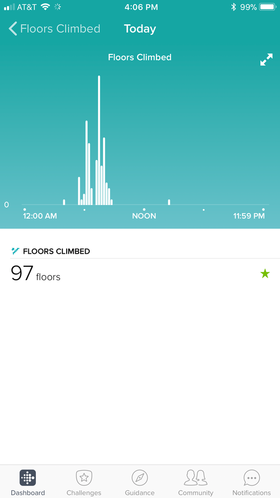

Ever since I got my Versa it seems to be grossly over exaggerating my stair count. I had the Charge 2 before the Versa and it was fairly accurate with my stair count, but now it’s more than doubling the number of floors I climb in a day.
Is this a known issue? Has the way in which the Versa calculates stairs climbed change significantly over the Charge 2? I’ve now gone from averaging 15 floors a day to 34.

Add me to the long list of people with the exact same problem. Just came off a HR2 to get the shiny Versa and amazed at the insane stair count. Spend a day on a tour bus.. actually did maybe 20 floors at best.. recorded 53+
My wife also has a Versa same day out and she managed 60+ floors.. Which is just a little insane.
This needs a fix or this is going back.

I climbed one flight of stairs today. I’ve also climbed into a box truck a few times throughout the day, so I’d understand if it maybe confused that with stairs a few times. But this is just ridiculous.

I finally received my replacement rose gold Versa. It has the same problem as the other two that I have had - it counts steps, floors and active minutes when I am driving. It seems to interpret steering wheel motion as steps, therefore it thinks I am walking and so elevation increases are counted as floors and time as active mintues. Sigh.
I'm using Drivebit, which I did find for iOS, but to have to remember to use it every time I get in the car or to remember to log driving time later on is just not a viable solution. My Charge 2 didn't have this problem, so I know that Fitbit can make a device that works properly.
I haven't decided what my next step will be. I really like everything else about the Versa and don't want to pop for an Apple watch, but really, how can they get away with selling an activity tracker that is so inaccurate?
I know that when I write back to them in my support ticket about this, they are going to want to run me through all the resets and so forth. Been there, done that, with two other Versas. It doesn't fix the problem.
I can't imagine why more people aren't reporting about this in the forums.

Some has already issued this problem in this topic but I would like to issue it again. Driving your motorcycle. What a pain for Fitbit! I used Charge HR for over two years and it also added quite much extra floors when you were driving. But Versa hit's the top knot! I'm really going mad with this. Today I just drove to my work and back, which is roughly 45 kilometers. Versa says I've done 46 floors. Insane. When I really think hard I've done maybe four floors today. Two weeks ago I drove something like 320 kilometers. Versa says I did 433 floors! Sorry that I really really really like to swear. But 433?!?! You really can tell that NO ONE does that during four hours.
I suggest that Fitbit adds an edit option to the floors. Same way the sleep does have it. You can edit your floor count in the end of the day. That solves many problems regarding people's mentally state about going mad with the floor count. And then you can start fixing the problem itself.

I hear you, @spirit_of_wind. I try to find clockfaces that don't show the floors because it makes my blood boil to look down and see that wacked out floor count.
I am currently using the Drivebit app, which exists for iOS and Android. So every time I get in the car (or if I get on my scooter) I'll have to haul out my phone and start Drivebit, then remember to stop it when I get where I'm going. This is such a poor "solution" that it irritates the life out of me, but it's the only way to obscure the false step and floor counts. Well, you could manually enter the "driving" activity, but that's even more work. And who can remember exactly what hh:mm they began and finished their drive?
The fact that my Charge 2 had no problem with car driving shows that Fitbit is capable of making a (much more) accurate device. It's just astonishing to me that they are not even acknowledging the problems with the Versa, much less making an effort to correct them.

Someone said the new altimeter is enclosed to keep it watertight. That's the issue.

I saw that post. However, that doesn’t explain why the Versa counts steering the car as steps and active minutes...
