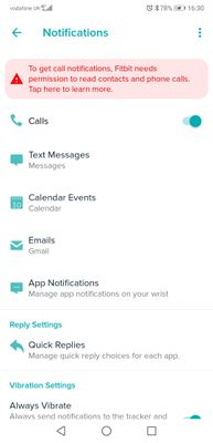

Hi can some one help, I've tried all the other support on here. I have a hawai P20 Pro, which has been working fine with my fitbit versa until recently. I've tried unpairing and pairing again, Bluetooth on and off, resterting my phone and the fit bit but it still not receiving any notifications that I have set up and it's still showing this message on my phone

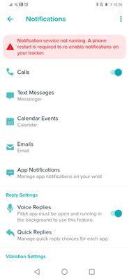

A couple of weeks ago when strava didn't work properly so I un paired the device, logged out, uninstalled and re installed etc, I've since swapped over to a different phone but still the same model etc and its still happening I've tried all the help in the forum

Thanks for your update and the screenshot that was attached into your post @Huskymam84.
For me to further investigate why are you receiving such error message, can you please specify which phone were you using before? Are you able to setup your device again with the older phone to see if you receive the same error message there? This way I'll be able to identify if the issue is with the phone as itself, your account or the Fitbit app for Android.

Thanks for your update and confirmation @Josiedol.
For documentation purposes, can you please share a screenshot of the same error message that you're receiving in the Fitbit app regarding the notifications feature of your device?
