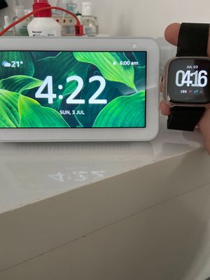

Hey,
i have synced and restarted my versa 10 times in the last 3-4 weeks and every time after about 2 hours or so the watch starts to run behind (time).
like I said I tried syncing, restarting, deleting the app and reinstalling and starting from scratch, NOTHING helped. 😩😞
And now I have even trouble to connect my versa to my phone via Bluetooth, my phone can’t find my versa.
Does anyone else have the same problem?
