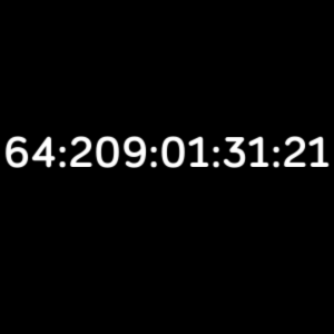

Exactly – a countdown to the day they turn 100. I kind of like the idea of having it as a clock face and not an app – a constant reminder of life passing instead of moving forward. Any ideas on where I should start? I’m a designer, but a programming noob.

Here is a basic version of the main code:
import clock from "clock";
import document from "document";
import { preferences } from "user-settings";
import * as util from "../common/utils";
// Update the clock every second
clock.granularity = "seconds";
// Get a handle on the <text> element
const myLabel = document.getElementById("myLabel");
//This is the target
//This could be entered through the settings
// or by using the web API to poll the user DOB and adding 100 to the years. let end = new Date("2082-12-03"); // Update the <text> element every tick with the current time clock.ontick = (evt) => { //Now Date/time let today = evt.date; //Difference in miliseconds let diff = Math.abs(end - today); let years = parseInt(diff / 31536000000); diff -= years * 31536000000; let days = parseInt(diff / 86400000); diff -= days * 86400000 let hours = parseInt(diff / 3600000) diff -= hours * 3600000 let mins = parseInt(diff / 60000) diff -= mins * 60000 let secs = parseInt(diff / 1000) diff -= secs * 1000 console.log() myLabel.text = util.zeroPad(years) + ":" + util.zeroPad(days) + ":" + util.zeroPad(hours) + ":" + util.zeroPad(mins) + ":" + util.zeroPad(secs); }

Thanks again! You kickstarted me into actually getting somewhere with the idea – I’ll keep playing with the clock face during the weekend.
So far I’ve mono spaced the digits and I’m toying with animations ... I’ll keep you posted.
