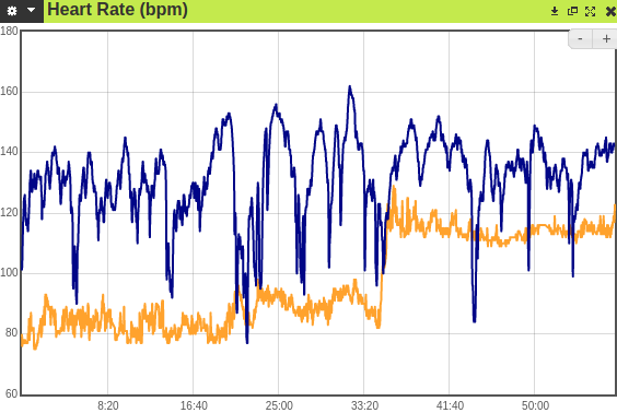

@JerryHam the more movement required the worse results are. I think with running and walking Fitbit has the easiest job to do but most other sports create a problem. On original Sense, the issues were exactly the same. See for example a session of badminton (orange - Fitbit Sense 2, blue - H10):
Several times I looked at the watch and saw "--" which meant it struggled with reading my HR. I usually wear Fitbit on my right arm but swapped my Garmin and Fitbit this time as I play using my right arm and this could affect Fitbit's readings (it wouldn't affect Garmin's as anyway it was paired with H10 on my chest).
Now, if I align the data by data points the I see Fitbit data ends prematurely:
Above means that Fitbit couldn't track my HR for almost half of the time (H10 captured it every 1sec, I verified that). There are many data points missing in the Fitbit readings. Watch on the left wrist shouldn't really have much trouble reading my HR (not much is going on with the left arm during badminton).
