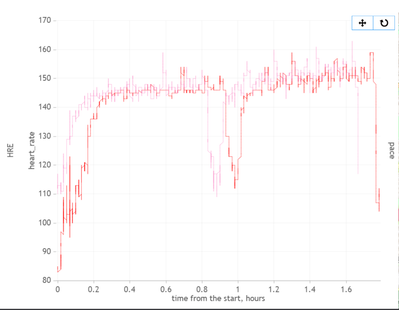

So here is data from a Nordic Ski. Red is the Sense 2. Green is a Wahoo Chest Strap. Purple is a Scoche Rythm+ on my left wrist. The Sense 2 data is so far off it's useless.

For the next test I looked at fitbits help page about heart rate accuracy. I moved the watch up my wrist two fingers from my wrist bone. Restarted the watch. There really is nothing else I can do. Did 1hr 45mins spinning. It did much better but its still very slow to react. Too slow to be useful for anything where your heart rate moves around. It can't get the peaks right unless you stay there for an extended amount of time. I think for general day to day walking around etc it's probably pretty close. Red is the Sense 2 the pink is Wahoo Chest Strap. It gets it in the ballpark but you can see how it misses the peaks. I think a Garmin watch is in my future.

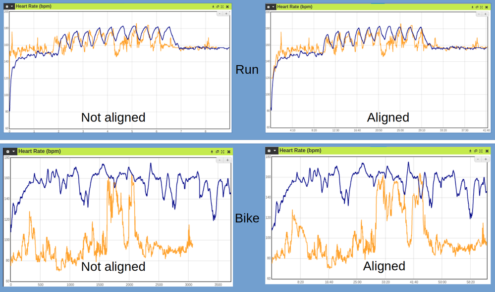

@mix123 it's not a delay, your data points aren't aligned properly. Different devices may skip some data points (Fitbit doesn't always sample every 1sec) and you need to align by timestamps. Otherwise, you'll see the such drift.

@mix123 here's an example of how alignment affects the readings (as usual, orange is Sense 2, and Blue - PolarH10):
Interestingly is that this Run is one of not many runs that Sense 2 did quite a decent job for very intense training (that occasionally happens but it had happened with Sense, too). I picked this particular run from my records to show that it's not the rule that Sense 2 struggles with high and rapidly changing heart rates. For the wrist sensor, I think this result was acceptable. The Bike, as usual, is totally wrong again (I have not a single record of correct HR during cycling). Anyway, look at the Bike "not aligned" picture. The data points end much sooner. It means that Sense 2 really struggled with obtaining the heart rate and skipped plenty of readings. Hence, placing data in the right domain is quite important when presenting such a comparison. We know that Sense 2 HR is exceptionally bad but we don't need to artificially make it worse 🙂

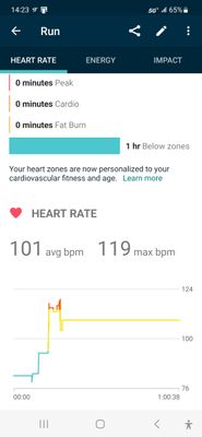

Here's a HR graph from my run today wearing a Fitbit Sense 2. Every previous fitbit watch would put my workout heart rate between around 150. Is something hard broke here?

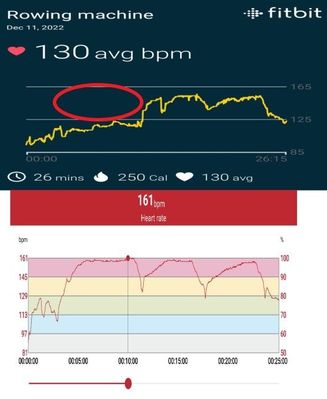

Tried the Sense 2 with a rowing machine against a Polar H10 chest strap...
Best Answer12-15-2022 08:06
