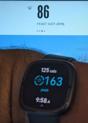

Often I saw this (HR on the Treadmill is from the iFit Band):
Real HR at 86, FitBit Sense 2 says 163 - 89% off.

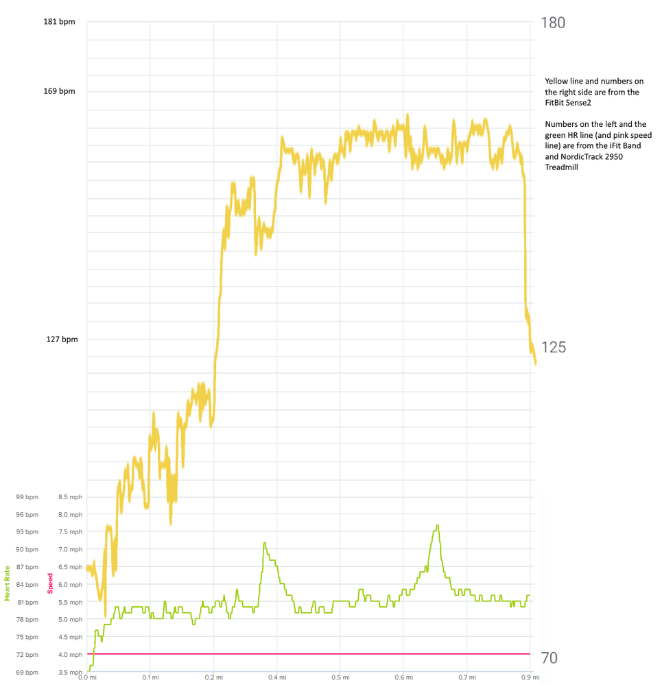

Here's the graph from both iFit and FitBit overlayed on top of each other. The numbers on the left and the green line is my HR per the iFit Band whilst the numbers on the right with the yellow line are from the Sense2:
Hard to believe it can be off by so much, but this is mostly repeatable; I've seen it time and again with power walks like this. Again, it is closer on my runs, but not close enough to use.
In this case, FitBit says my average HR was 140 and the max was 164. But in reality it never even got over 94.

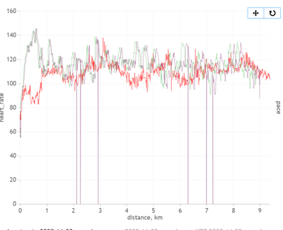

This is crazy. Nordic Skiing. Red is the Sense 2. Green is a Wahoo Chest Strap. Purple is a Scoche Rythm+ on my right wrist. The Sense 2 isn't even remotely close. Having the Scoche on the other wrist gives a good idea that wrist based HR can be fairly accurate. It lines up very close to the chest strap.
It's actually hard to believe it's this bad. I originally just looked at the average and max and thought it was OK. But it's not.
Check this out. I compared it to 2 other heart rate monitors on a nordic ski. One of the others was wrist based on my right arm.
https://community.fitbit.com/t5/Feature-Suggestions/Fix-the-Sense-2-Heart-Rate-Sensor/idc-p/5281130#...
