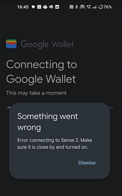

Yes, I've tried that and I still get the same error
"Something went wrong. Error connecting to sense 2. Make sure it is close by and turned on".
Pretty sure it's been disabled by Fitbit just to make us miserable.
05-08-2023 15:47
05-08-2023 15:47
If this problem isn't affecting all Fitbit Sense 2 users, then we are the select few. Since changing the account has no effect, the only consistent piece is the hardware. It's either a hardware issue (unlikely because the NFC tag is testing active/working with NFC tools) or it's an intentional software block on the serial # for RMA'd Fitbit Sense 2. Why? No flipping idea.

This issue is with Warranty replacement Watches, for some reason the watch is not allowing the Installation of Google Wallet on the watch. I am aware that the new watches do not have this problem. I can install Google Wallet on my old Sense so it is not the software it has to be the Refurbised Sense 2 that they sent as an replacement. I think it has to do with the NFC settings on the watch itself.
Can't add cards it the Wallet will not load to the watch, can't get past the first screen on the app. It will not sync with the watch.
