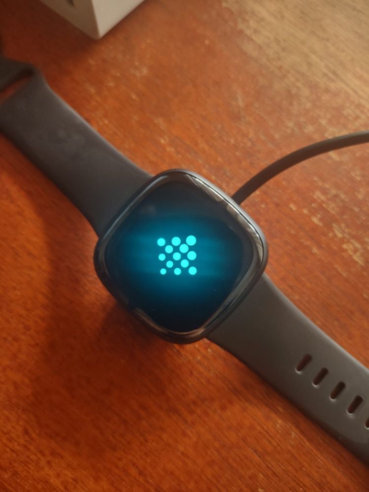

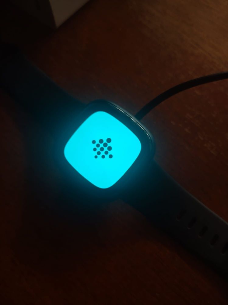

The EndFinally got back my screen to light up after the battery was completely drained but now its in a Update loop that will not stop updating by itself. My battery is currently at less then 5 procent it is synced to my phone now, but every time i want to keep going to makes sureeee to start updating to a new firmware.
From what i can see my firmware version is: 60.3001.153.50 and i have a Sense 2.
This is very very annoying as i stated previously. i had to resort to my existing Versa(1e gen) and TBH and IMO the screen reaction and display is faster than my current sense 2.

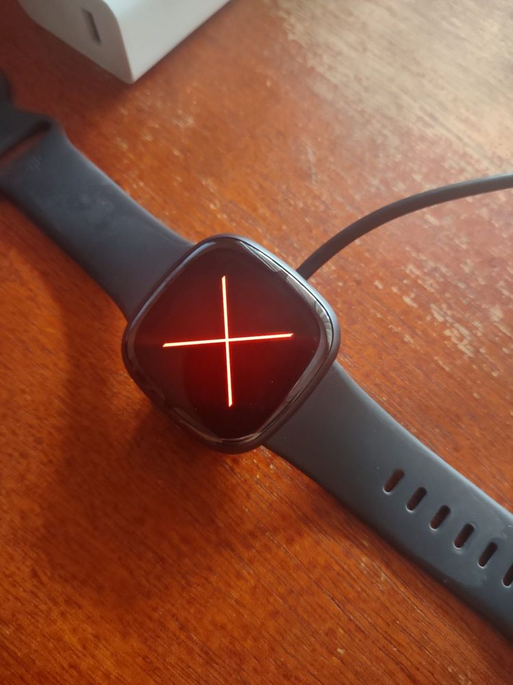

Its asking me to choose a language and to sync to my phone but it keeps restarting on its own. WHY FB WHY?
That big red cross after constant restart is very very annoying.
Firmware 153.50 is the original firmware. I think they have suspended firmware 194.61. Your Sense will update to 184.52 . It was released in nov or december last year and is stable. First - Charge your Sense to at least 50% - Clear Fitbit App cache - Restart by pressing the button for approx 10 seconds. Sense 2 uses Blutooth to update - keep your phone close -
I performed a factory reset on my Sense a couple of days ago - and it restarted a total of 8 times before the installation of firmware 184.52 was complete.
Hope this helps.
@LokeAa ended up and started to do the same thing. finally i have no screen once again. can't add my fitbit to my device, clear the cache clear everything. removed the device from my phone still no luck. now that i don't see anything gotta wait once again when the battery drains again. So this will take approx 3-5 days.
It keeps trying and trying to update. but i am a person with a lot of patience but not when something gets messed up by something that's supposedly will improve what you currently have.
