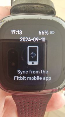

My watch has been stuck on this screen since last night when I updated it. The battery depleted over night, charged it to 100% and 4 hours later I'm at 66%. I can't use the watch. The app says it is updated and synced. How can I reverse this update? Before this update the battery lasted days and never gave me any trouble.
