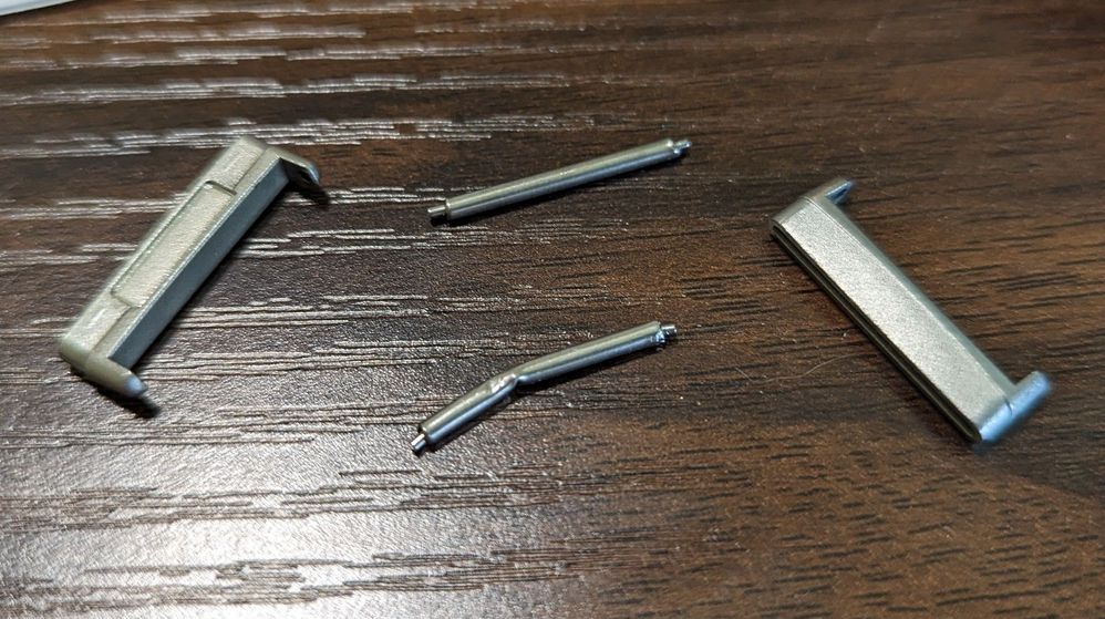

Okay, I've found a workaround to get a bracelet type band that will fit the Sense 2. If you want this type of band, you can purchase any of these:
I love these bands, they are really pretty and not as gaudy as most bracelet type bands. You could really get any band that has the little spring mechanism at the end that fits into the clasp piece that then goes into the watch hole. But it MUST have this spring mechanism. If you look in that photo, you'll see the little spring bar. It's just like how the bands used to work on my older fitbit.
Then you must buy this band:
Once you get that band, you just remove the bar that is connecting the band to the clasp piece. You just have to force it off. It shouldn't hurt the clasp piece, it just bends the bar and it comes off. You no longer need that bar. Here's how it will look:
Then you just insert the spring mechanism into those little holes and you have your watch band that fits the Sense 2. Is it ridiculous that we have to jerry rig our own bands? Yes! But at least there is a way if you want it. Anyhow, hope this helps someone.
