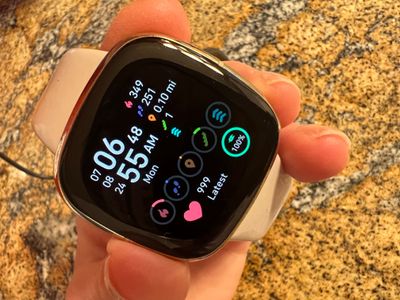

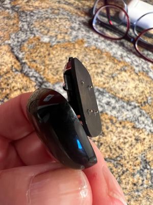

07-08-2024 14:56
07-08-2024 14:56
I love my Fitbit Sense and have had it for a few years without fail. However there are complaints about the charger and the magnetic pins. One of my four pins the spring broke so it is not connecting. I took off the back and used a small whilling and hammer to push it back up a bit. It worked! And I have ordered a new cable. So this was only a temporary fix.
